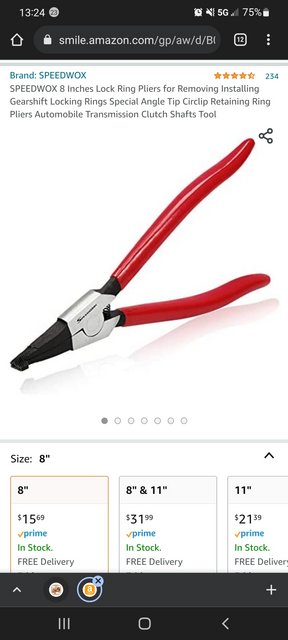

So these devil clips... I don’t have the right pliers for them. Ordered off amazon for 12.00 and arriving Tuesday. I used every set of snap pliers I have (whole icon set, a crescent set, and a no name brand kind... not good enough. ($120.00 worth of useless snap pliers it turned out.
So I’m at a standstill for the T90 till Wednesday after work.(maybe Tuesday, but my track record of getting out of work at a decent hour is terrible).

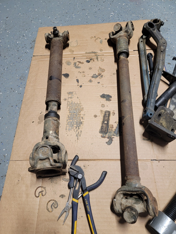

So I started taking the driveshafts apart. Crunchy!
I did index some punch dots on the yokes and body of the driveshaft before I took them apart. Used an entire can of breakclewn and dunked these in the evaporust

Cooking right along with reassembling the T90 now that the snap pliers arrived from amazon. Took less that 10 seconds to get the ring on... Wink never a bad reason to buy tools...

Could you please give us a photo and a link to those snap-ring pliers you bought that did the job?
Joined: Nov 28, 2019
Posts: 379
PostPosted: Wed Jan 12, 2022 12:22 pm    Post subject: Reply with quote
Sorry I thought I posted the photo but I guess I deleted that instead.
https://smile.amazon.com/gp/aw/d/B07QWTB149?psc=1&ref=ppx_pop_mob_b_asin_title
