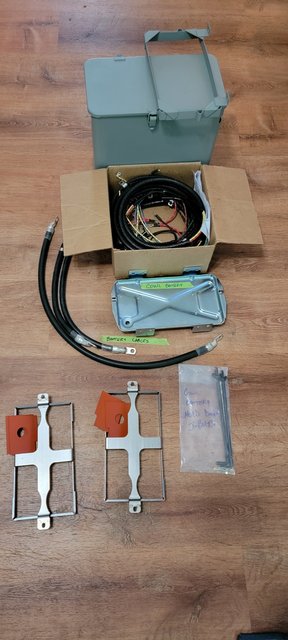

I ordered a pair of these hold downs and they look great.
(photo by wesk)
you have to email Fil Bonica to purchase it. I mistakenly emailed Guy Loomis not knowing.
I purchased two uncoated hold downs. and they came with the little rubber pieces (to prevent a grounding of the battery cables).
I paid via paypal and the package was in my house within 4 days.

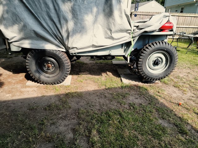

Joined: Nov 28, 2019
Posts: 303
PostPosted: Sun May 22, 2022 4:30 am    Post subject: Reply with quote
yup. grey all around.
I am going to go ahead and paint the rear wheels too.
Last night I fell asleep around 2030. I get terrible sleep every day so I go early, and maybe 15 minutes after being asleep- I heard the wind pick up. It wasn't supposed to be storming.
I saw what was happening, got up and outside to take the canopy tent inside and just as I shut the sliding door the wind whipped and I saw the trees twist as the wind spun in a circle. Rain went completely horizontal and the thunder cracked and lightning hit down the street.
We had tornado type activity here last night. It happens a few times a year, and nothing as bad as the mid west gets.
In all- everything is fine. It took an hour for that storm to roll north of my place.
Jeep stayed on the jackstands. I had the tires back on, and lug nuts tight, I just left it up on jacks last night before bed.
