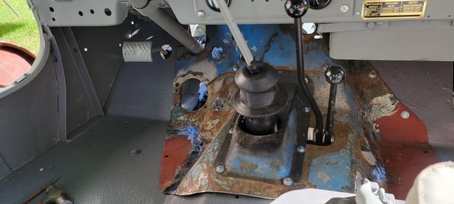

over a year ago I purchased an aftermarket transmission floor cover and I never liked how it was going to fit and the amount of mods I would have to do to make it fit.
Decided to mod the old one that did fit, to add new panel pieces.
a true back yard build... doing this all in the dirt and grass.
I need a riv nut tool- I broke mine and dont feel like going to HF again for a same thing- ordered one on Amazonia and it wont be here till monday.
Int he mean time, the panel is fit and the holes are drilled.

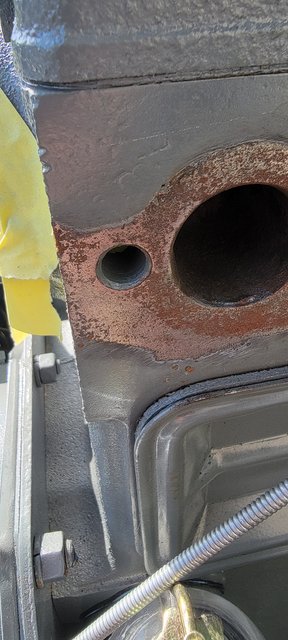

Also- gotta decide how to deal with this.
The forward and aft stud holes are bigger than the 3/8" and the threads are barely there but then again- they may be but i cant see without zooming in or putting on my glasses. either way, I need to find studs for these holes.

That large a stud may not fit through the hole on the manifold?
Install a threaded insert or helicoil the block back to the original size stud?
Or use a stud like this? https://www.oreillyauto.com/detail/c/dorman-autograde/performance/exhaust/exhaust-manifold-header-bolts---studs/1ae38bae6636/dorman-autograde-3-8-24-7-16-14-inch-thread-manifold-studs/dag0/675044

Rivetnut tool came in. all done.
I put the panels back in, just for the photo. I had let this dry for over 24 hours, but full cure is around 3-7 days.
So I took them back out after that.
Overall very pleased with it.
Few things I will be the worst critic on, but that's fine. I built it.
Putting 70 year old metal back together and I'm no pro-
I really like the light quartz grey more than the medium i had on there. Under the body, and lower piece of the rear wheel wells still are medium grey- which I think I will leave. I have 1 quart of unused product still- My feelings on this may change.
I noticed the contrast of the frame vs the canvas is very similar to the floor vs body color of the tub. I will put the seats back in later this week.
Thank you for the heads up on the two size studs. The local parts houses wouldn't order them. So- Amazonia it is. I expect them to be here later this week.

I hope you checked that the manifold hole in your block is actually 7/16" coarse thread?
I was taking a S.W.A.G. from your photo that's the correct size when I suggested using them because it's the typical one size larger up from 3/8".
Don't forget thread sealant when you install them as all 7 penetrate the water jacket.
And remember that the center stud can be an interference fit with the head stud right behind it.
You don't want them colliding under torque pressure.
I've read it can induce cracks or leaks.
