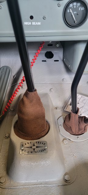

Haf this placard from my last ships Steering system when it was upgraded 4 years ago. THey were going too throw it away so I snagged it.

PostPosted: Sat Aug 26, 2023 9:29 pm    Post subject: Reply with quote
I like the plate, fits right in...
in that picture I noticed you have leather boots on your shifters, you really should consider putting on the rubber ones with hose clamps on the trans tower/lever. The transmissions are not water proof without the boot and any water on the lever will run right into the trans...that's what destroys them when the are left out in the elements unprotected.
Mike B Smile
