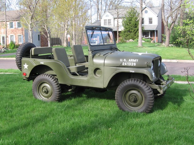

Well I didn't totally finish the vehicle this spring break like I had planned, but I got #@$%@ close!! Only the brakes and headlights remain, along with fixing a few grounds. But hey, I can get that done after school this week.
After doing some last minute checks, and fixing some last minute little things, we fired it up tonight and drove around the block. Man, that was so cool. I couldn't believe it actually worked.
I still have some homework due tommorrow and I'm so thrilled, I doubt I'll be able to do it. Oh well.
Pardon my mess in my garage. Had to move allof the stuff that was sitting in my jeep somewhere.
I made all of the lines and stuff my self. My wiper / distrib tee is a little different, but I couldn't find the proper stuff at NAPA this week, so I just used what I had. Will have to order to get it correct. But hey, it works.
Those are not the original markings. My great uncle (who is still alive) served in the Army in WWII, and I used his information to try to formulate the correct style markings. I would have never have known where my jeep originally came from. My bumperettes were off of some old CAP jeep and my bumper was a piece of C channel before I replaced it My hood number is not known too, as I couldn't find them under the layers and layers of OD.
Yes I know my oil and water temp guages are civvy type. I have the old stuff including the sending units. But when I first fired the engine this last summer, I felt it would be best to use mechanical guages of those to eliminate the possibility that the sending units could be bad. Hopefully sometime soon I'll get around to putting the original stuff in there. Gonna drive with them for a while first to make sure everything is in good working order.
Thanks for everyones help!

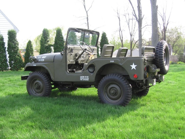

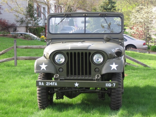

Bob_C
Posts: 271
Location: Chester County, PA
Post by Bob_C »
Heres some from yesterday:
The markings corrospond to the unit my great uncle (still alive) served in during WWII. I never really could figure out the original ones to this jeep -- as I have no idea which bumperettes are original to the jeep (got a box of em), didnt have the original front bumper (replaced with C Channel), and I mustve blown through the markings on the hood. Wes helped me generate that number on the hood currently.
Bob Collins
1954 M38A1 MD79056
