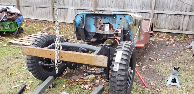

Well let’s just say that I am a dumb dumb. I move down my Dana 25 out back because I needed to do a brake job on my friends truck (long story but older lady from the base I used to work at asked for vehicle help because local shops aren’t so honest). Anyway, I left my jackstands up in high position, I should have dropped them down. When I was rolling the axle under the Jeep frame, the rear JAckstand didn't like the soft ground, (it rained a ton last night) and the higher front angle to give me clearance. And down she came.
I was absolutely safe distance away and the dogs were inside so no one got hurt. I finished the axle installation and then lifted the rear to the lowest jack setting and left it that way.

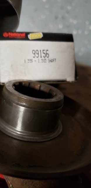

I got my rear Dana 44 yoke sleeve yesterday. They sent to the wrong store so I had to drive the 15 miles south to the bad side of town to get it. It went on super easy. This part was listed in ryan’s book.

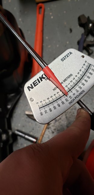

Got my Dana 44 pinion preload set.needs to be 14-19 inch pounds,
Image I have a 18-19 all around,

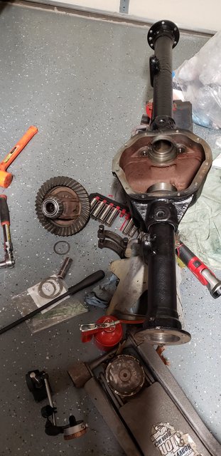

I started working on the Dana 44 carrier bearings but I needed Tylenol for my aching back and it’s time for dinner.
I’ll finish that tomorrow night,

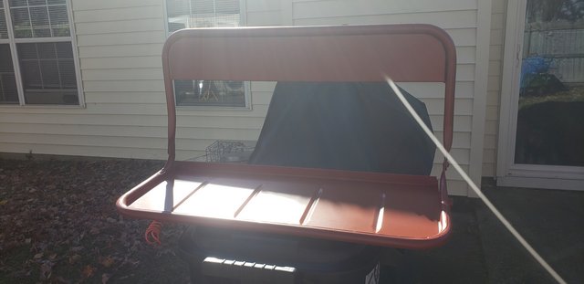

my repop rear seat came in. fits in between the wheel wells which is a good sign. I need the support brackets still which are on back order.
I am waiting on my driver seat too.

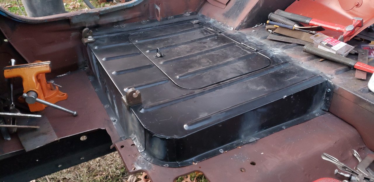

I spent half the day in the cold outside working on filling this hole.
4 hours later
there are a couple pin holes I need to hit with the welder again, and start banging out some dents. The top dent at the passenger rail above the shovel is not going to be fixed. I am leaving that.
I didn't get to the tool box installation as it was getting right cold outside and temps dropped down to 40. long johns and sitting in the wet mud all day didn't help.

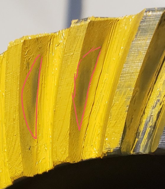

Messing with the Dana 44 today.been a lot of moving shims and all.
Remember used gears, new bearings. Pinion Preload sat. Ring gear backlash sat. Coast side of pattern looks good. The drive side has a shadow of where it’s worn in.
I’d prefer to replace this ring gear and pinion in a perfect world, but it will have to do.
Coast side
I’m still going to keep at it until I am satisfied.
