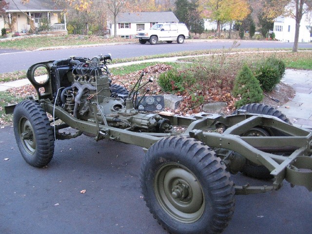

Nick from AJP (George's partner in crime) took a look at it today and was equally confused about this. We were on the phone with George a lot, and another guy in New Jersey that used to work with AJP and still does military restorations. We came up with a couple theories of how this happened, and how to fix it.
Part of the problem is I don't know what the correct position is. If I put the tub on so all of the hat channels line up, the fenders don't fit...nor does the hood. If I put the fenders on perfectly, the jeep extends off the rear cross member 1/2-ish of an inch. I thought the M38A1s had a flush rear...that is to say, the back panel and rear cross member were flush. But George was saying that they can overhang just about the same distance as mine.
With that said, we're all using the front end as the "Bible." If I line up the fenders correctly with the grill, they also line up with the proper holes on the frame, so that leads us to think that the front end is correct.
We also talked to the previous owner that had this jeep. He was equally puzzled, as he said when he took everything off 25 years ago, it worked.
Took a look at some pictures I took when I recieved it. Take a look at this rear panel:
As opposed to the picture of the other one on one of my previous posts. To me, that looks flush.
The only question is if the owner left it in that position or if he moved it forward to that position. I do remember most of the bolts being out, and the remaining loose...cause I remember he was going to do some work with the tub. Now that I think about it actually...he restored the frame way back when, so he HAD to have taken the tub off...and probably just placed it back in the most logical position.
We were going to try to bolt everything up, then slowly pull the tub forward with some straps and 2x4s running across the grill and dash. Not to get it in the perfect position, but rather, to move it closer so it lines up. But I was afraid of buckling the fenders. And actually, now that I think about it, that cant work...because then the hood wont fit correctly, right?
....what the heck went on here? This is annoying!

You said in a previous post that te rear end had been damaged in a wreck, could the rear frame been reworked to get the damage out???
In your situation I would mount the front clip and work backwards.
Also measure your fram length to see if some metal has been removed somewhere... 25 yrs is a long time to remember everything...
My 2 cents worth...
My 2 cents worth...

I personally never checked the frame for squareness, but when the previous owner undercoated the frame, all of that happened.
Square or not square, I still come back to the datapoint that all of this stuff fit years ago until the previous owner started to take it apart.
The fact that the hat channels that I never touched, and the vertical support that runs behind the passanger and driver seat (that I also didnt touch) dont line up either when the fenders or grill is mounted is super puzzling.
Hal - Frame was never cut. WHen I say accident, It was either a minor accident or someone simply backed up too far. The frame was untouched, that part is totally straight.
There was one modification I found on my frame. 2 diagonal pieces were added. Both running from one side of the frame to the rear cross member. But I found OD paint on that, which suggests to me that it was a motor pool modification.
Also, if it was cut or bent, that would mean I would have a helluva time fitting the powertrain in. Driveshaft distances would be messed up, spring shackles would be in the wrong place, the crossmember that runs under the transmission wouldnt of had bolted up, and finally, the distances that my fenders are off would be different. Keep in mind, both fenders are equally spaces off from the mounting holes in the grill AND in the frame.

You have a vehicle that is half a CENTURY old and God only knows what actual repairs have been carried out on it iduring those 50 years.
You have given us a lot of conflicting data and have yet to comply with a test fitting we have asked you to do.
Install the tub with the two vertical front mounts bolted up and then tell us where everything else falls. It would help if you took the above photo of the complete frame from my site and drew the resultant alignment locations or error for each tub mount.

- Posts: 1689
Bob,
That rear M38A1 photo that Wes just posted appears
to have a mall over-hang.
If I understand this so far:
The front sheet metal and the tub mounting
locations do not line up when assembled together.
After you assemble the front sheet metal, then the
tub does not line up to the frame mounting holes.
This could mean:
1. Tub and Fenders were not together, even if the
paint schemes are similar (could the previous owner
had two M38A1's painted similarly and then mixed up
parts when working on them?)
2. Tub or fenders have had some damage in the past
when on the vehicle or off the vehicle.
(ie: bent mounting bracket, etc.)
3. Frame could have some damage. NOTE: A small amount of
damage in one location can have a fulcrum effect. Ergo, the
damaged area may be small and not obviously noticable, but
can have demonstrable effects further down on the frame.
This could be something as small as a mounting bracket on
a panel or on the frame that has been bent a little.
To rule out number 3, you can measure the frame points
listed in the manual that Wes mentioned.
To rule out number 2, you could take your fenders/ tub over
to AJP and measure it against one of theirs. I am sure they
have some parts laying around. You could also ask to borrow
one of thier pairs of front fenders just to see if it would work
with your tub.
Now if the frame measures out OK and you cannot obtain
alignment, then either 1 or 2 are the most likely, no matter
how improbable they are.
