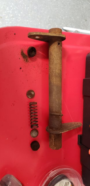

Lost a brake shoe brass cam at some point. I bagged and tagged everything but it walked.... so I ordered another one and am waiting on it so I can finish the dana44.

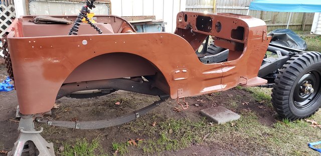

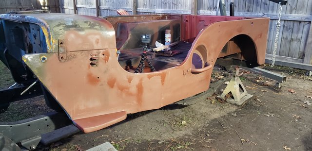

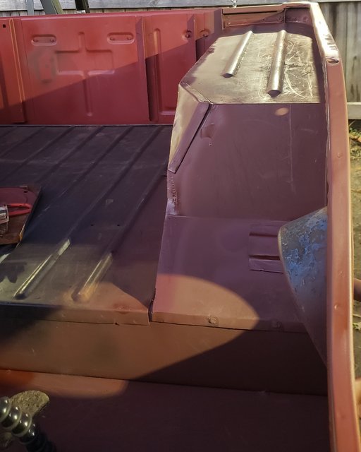

If I was a better welder I wouldn’t have spent half my day on fixing my screw up.
Originally I installed this with the seam on the inboard side( overlap in the red area instead of in the wheel well).
Spent time filling holes around the drive side. Spent too much time messing with getting stuck hardware out. It’s rusted and seized. Next time just grind or cut off wheel.
My days are too short and it’s chilly out.
Up next, fill the passenger side extra holes.
Maybe get the floorboards finished.
Not perfect but will be functional

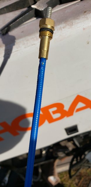

Replaced the liner in my mig welder. This is the old one. Looks damaged (it is 5 years old...

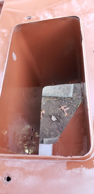

The cowl battery box was filthy. Took a wire wheel on a grinder to it.

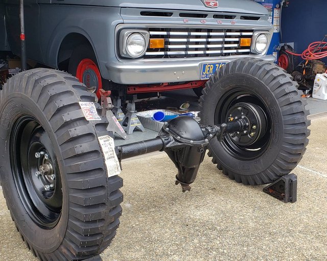

Dana 44 axle setting. Had to put a lot of shims on the driver side- but it was like that befor too. Like .090 on passenger side was around .035
All the brake parts here, shims, gaskets... was missing two 3/8-24 nuts for the brake adjusters. I had some in my stash actually.
Got a .003 on both driver and passenger side. (It’s not backlash- my brain is not functioning at the moment- it’s the in/out movement)
Spent a little time buttoning up the Dana 44. I need a differential breather but otherwise is 98% done. I plugged it for now so water can’t get in.
Rolled it out back and put it under the Jeep again.
Those bolts gave me heck on the driver side.
Passenger side went in licking split, but the driver side was three times as long. It dropped so fast in temperature and daylight. I started at 1400, it was 1630 by the 5ime I finished and cleaned up.
The ground is soaking wet and of course I was lying on a piece of plywood to keep from getting soaked through.

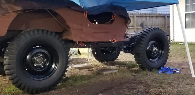

We have a roller.
We have a roller.

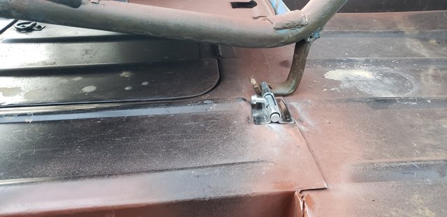

I added the barrel latch (nifty idea I saw on here -on someone’s build)

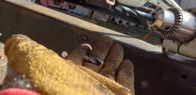

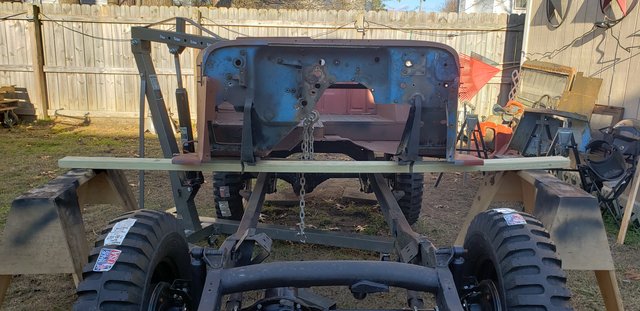

Today i worked on the frame. I forgot I hadn’t taken care of those seized front fender bracket bolts broken off in the frame.
I got one grill mount bolt out successfully and moved on to the passenger cowl bolt and fender bolts.
Well, the first drill bit did fine. Second one, exploded as soon as I put it at the drilled hole.
Wear your face shield. I did thankfully. This piece flew up at my face like shrapnel.
Instead of fighting, I cut, grind, weld.
In all I made 5 patches for bolts that were seized.
I will locate the mount hole once things are lined up and drill the holes.
Tomorrow may rain a lot. Have other projects to do inside if it does.

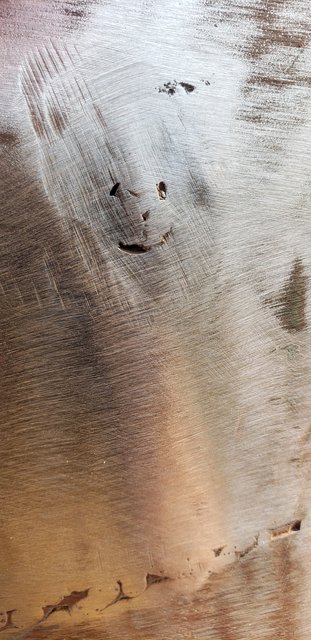

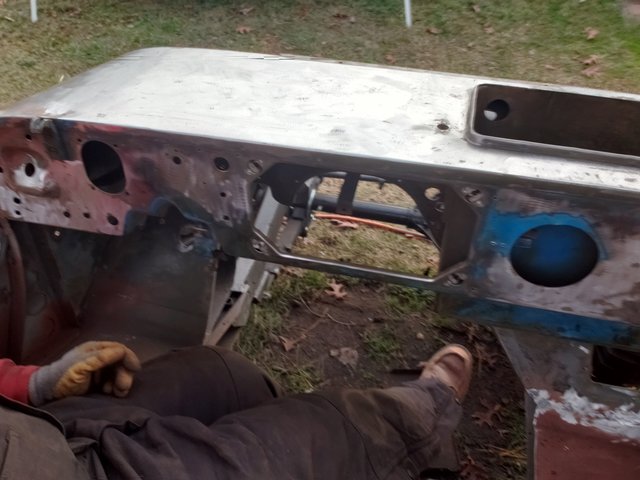

Forgot to post this photo. Got poking around the firewall since I haven’t touched it yet. Cancer just brittle metal right where the battery box is.
I did not want to take the cowl battery box out.
Let’s see what sort of damage I can do without taking it out....

The battery fumes just eat the sheet up in the battery boxes and firewall area.
Then, there's Bubba. The big hole and surrounding holes were for a chrome paper air cleaner mounted inside where the cowl battery box used to be......
This is what I started with:
http://willysmjeeps.com/v2/modules/gall ... cutout.jpg
Repaired:
http://willysmjeeps.com/v2/modules/gall ... inted.jpeg
Like you said, not perfect, but it will work.

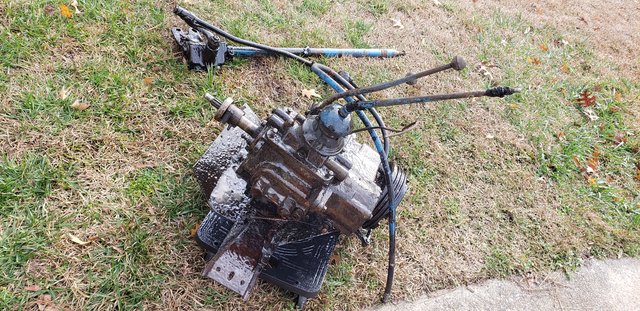

Dropped the bar in my evaporust solution
Weatherman said it was gonna rain all day so 8 sudds the trans up ready, but it never came. (Till 5 pm).
So, I can’t sit still, I started disassembly and ended my night when the deluge of rain did start at 5pm.
Not much oil leaked out cause it already marked territory long before I owned it.
It is so gunned up, it was like chipping concrete.
