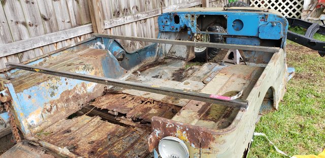

So, I can repair this. There is just a lot of work in it.
time to put together a list of patch panels....

Panel replacement will be much simpler if you avoid offshore import panels. I would suggest sticking to US made panels either with Midwest Military in Prior Lake, MN or Classic Enterprises in Rice Lake, WI.
https://store.midwestmilitary.com/category-s/1477.htm
https://www.classicent.com/jeep/mb-cj2a-3a-3b-m38
When I rebuilt my M38 body one of the biggest problems was the front floor board and firewall and hat channels. I was able to buy a complete NOS floorboard, firewall, hat channel panel that fit in perfectly and also fit perfectly with the Classic Enterprises and some Midwest Military stuff like the lower cowls and cowl supports.
Brent Mullins has several of these NOS floor board, firewall hat channel replacements and also has the floorboard hat channel NOS panels that would attach to a current firewall. They cost but compared to a body they are still cheap if you can do the fitting and welding.
If you go to my photo gallery you will see pictures of the parts I am talking about. My body was bad but from your pictures yours is worse. But if you can revive it or find a better one to rebuild you will probably still be better off than trying to put a MD Juan body on.
If you are looking for a body that might be in better shape I think I know of one here in Texas that was available a few years ago. If you are interested let me know and I will attempt to contact the guy who had it.
yeah I took a look at the photos. My M38 body is worse off I think.
I sent a contact request to mullins about a floor section. we shall see. if they dont, i will still be looking for a body tub, but i am planning on making a big purchase of panels from CE. (like 2500)

Determined which way your going with the tub? Our MD tub was swiss cheese as well and after adding up all the patch panels, factoring in time to clean up and weld in the replacements to only be left with marginal metal in the remaining places we bit the bullet on a tub kit. At least for the MD there were several areas that needed to be massaged but overall it's significantly easier to fix those flaws then trying to erase 70+ years of corrosion.
Not saying you can't fix the tub but if you are looking to go nut and bolt accurate, by all means keep the tub and try to repair. If on the other hand you want to have a reasonable cost in the rebuild then do the math and add in all the materials you will use. Rust preventative, welding supplies, etc... don't come for free. The economics were clear for us.
