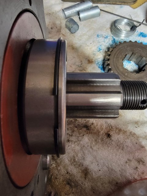

Cooking right along with reassembling the T90 now that the snap pliers arrived from amazon. Took less that 10 seconds to get the ring on... :wink: never a bad reason to buy tools...
Couldn’t find my shift tower spring. I have the table and dolly cart where the parts are, it’s gotta was there...
But can’t really assemble that fully yet as I need to get those roll pins for the forks.
Anyway, the weather should warm up to the 50s today so I’m hoping to at least slap the top on the case and spray some paint on the transmission.
Found he spring. Hidden in plain sight.

Was trying to get the bearing to seat against that spacer and plate, but couldn’t. It had a gap.
I took it all apart again, and switched the plate.
Fit, so the new one must be cut wrong. When I was putting it together the first time, I didn’t even realize they were slightly different.
Shift tower reassembly is next. I have some NOS shift rail pins coming. Was very cheap so I tossed in on my order for the horn rod.
I see you are employing the old wire trick.
