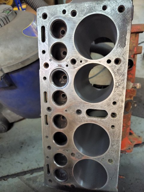

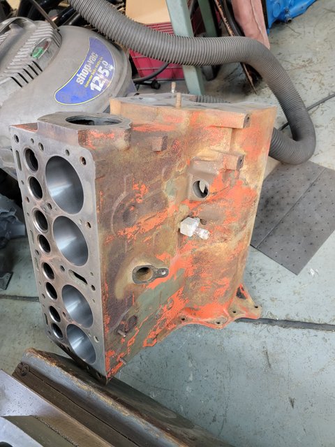

Ran by the machine shop to check on progress. They have bored the cylinders. But in line to be decked. He said he is going to try saving the serial number, but can restamp it.
No where near ready to be built.
Should be ready to pick up in April.
No cracks in the block is great news! And a block that's never been decked before is also a bonus!
The cylinder bores looked sleeved already? How much overbore on the cylinders did they do?
They haven’t been sleeved. The Jeep only had 30k miles (and title original miles)
I think he said 30 over.

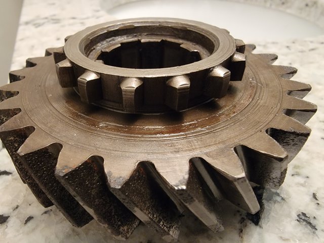

Well after 30 minutes looking for it, I found the old main shaft gear, but took me a little longer to realize I did not buy a replacement! Ugh....
I really want an overdrive.but can’t justify spending 10x for a herms overdrive set up just yet.
Will get on and order a new gear.

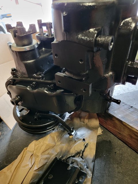

I did mate the transmission and transfer case together today. I had hoped to spray paint them together today but the WX temp started dropping quick.
Not a fan of how the push on transmission knob fits. May thread it and make a knob for it.

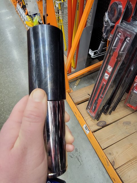

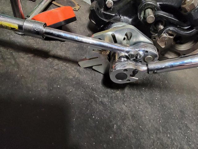

Earlier today I went to the big orange box store to look for a 1 1/4” socket. The two I owned are too thick walled to fit to tighten the nut.
Between the two available there, I bought the chromed 12point Huskey instead of the 6 point impact socket.
The minimal difference in their size allowed me to get it in there.

Thanks for that shot of the nut being tightened.

April I've got 2 spare 26T gears I will be happy to send you one for the price of postage. Nice and clean they are.
RICKG wrote:April I've got 2 spare 26T gears I will be happy to send you one for the price of postage. Nice and clean they are.
Well son of a.... at 0400, I went on RFJP and bought a nos one for 80. KW was wanting like 120 for an unknown. Thank you, I guess I’m 80 deep on that- bought the shift rail plugs ( super cheap compared to KW).

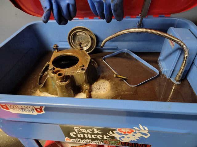

Today, I did some cleaning.
The bell housing is so gunned up. Was brand new purple power...
