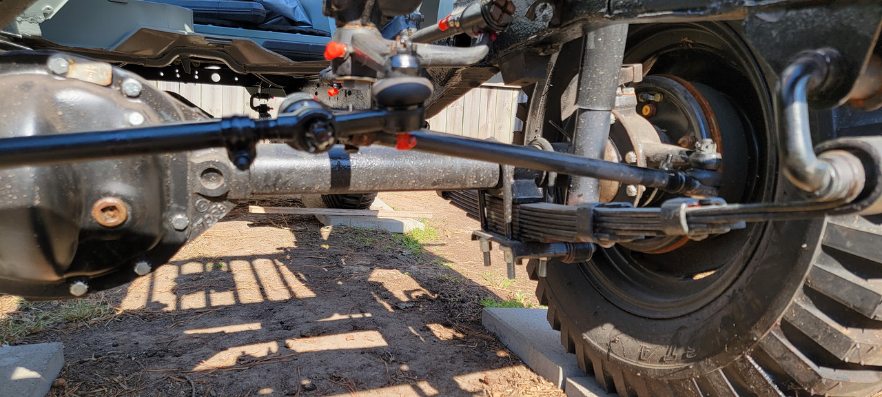

Look at those rear leaf springs. FLAT!

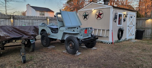

Ive got 70 degree weather and I decided to do some jeep stuff before I leave on my deployment again.

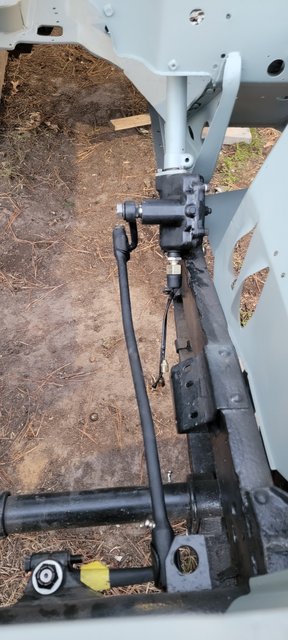

It is not tightened down yet, but today I will. I spent some time in the yard with GrandpaReid doing the steering hook up. Checking for straight, and lock to lock turns etc.
Took a few times to hook up and find a point I was happy with (on the jack stands)
Will torque and grease everything today.

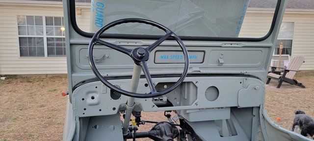

Set up the horn switch too. and showed my dad how to use a meter for resistance.
so, I actually torqued all the suspension bolts, tie rods and the like today. Put new grease fittings on the spring pivot bolts cause the ones provided were junk.
Put grease to all fittings. Put my little red grease caps on.

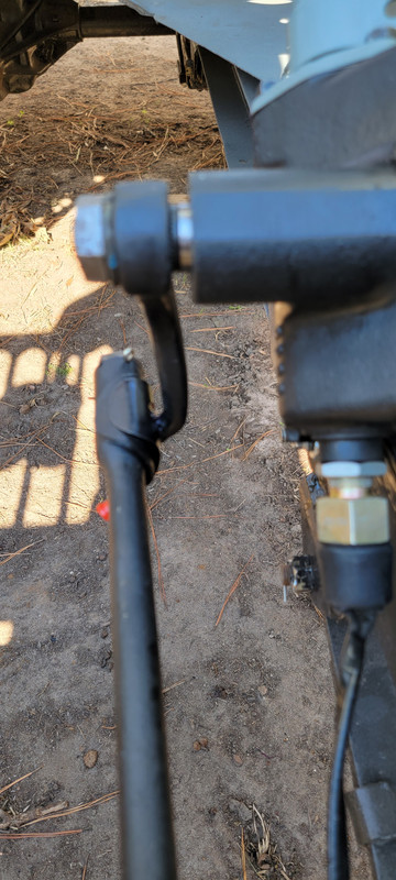

Torqued the steering pitman arm down too. but this doesn't look right. The way it was previous was pressed right up to the housing of the steering gear.

Your photo is a little fuzzy, and without measuring, the spacing on my pitman arm and shaft look like yours.

I bought a suspension kit two years ago. I installed that kit. It had greaseable pivot bolts for the springs and they came with little cotter pins.
I had to drill out the eyes on those brackets and I nearly took my dang arm off with the half inch drill again. I hate that thing.
Anyway. 3 of the 4 bolts I can put the cotter pin through. 1 is too short.
I contacted the seller. They sent me another pivot bolt. that too is too short.
I didn't measure but i will when i get back from my PTSD inducing trip (trust me- everything breaks and goes boom! at least once on the trip and always at the same time when its a bad sea state).
Will deal with when I get back. But seriously- I am a bit ticked off.
