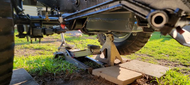

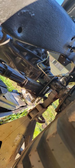

I completely forgot I needed to address this on my front springs.
The spring center pin doesn't sit quiet right. I need to squeeze the springs together just a tiny bit to get them to sit right on the axle and then tighten down.
Not sure how I am gonna do it yet. I do have a hydraulic enerpac system. I think I can get a attachment to pull. - time to do research on getting that.
I tried a large ratchet strap but that doesn't give me enough leverage.

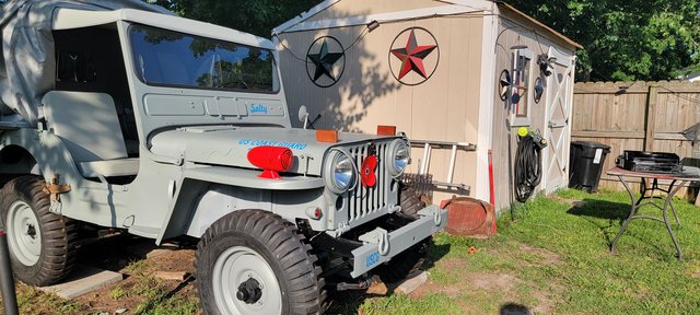

61 M170

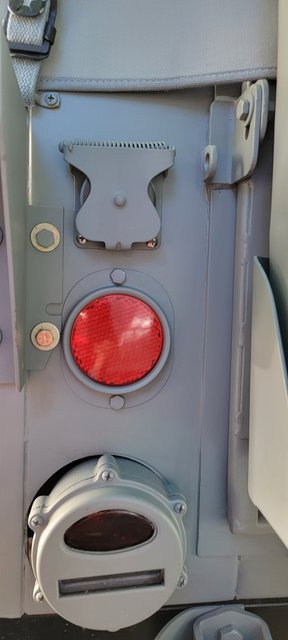

painted the rear wheels, installed the front bumper back on after it too was painted.

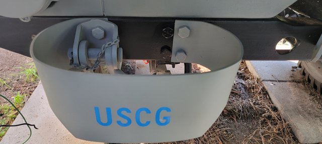

Put the rear tow chain plate on under the pintle hook.
Painted the bumperette "USCG"

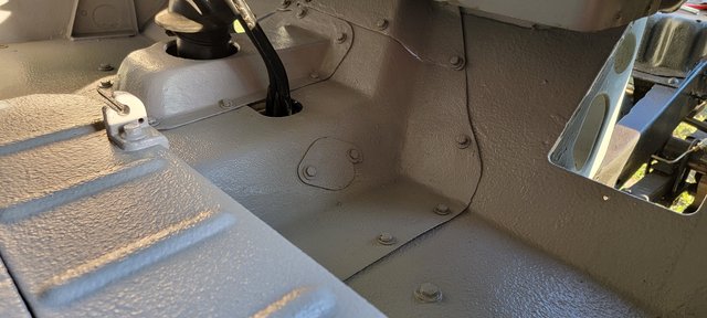

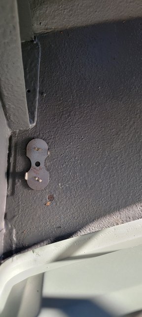

Question-
Where exactly on the floor do the drain plates go?
I have not installed them. I havent drilled the hole yet. This is on driver side- the hole drilled is for my seat mount.

If you pop into Wes's album on the first page is sub album M38 body and it has alot of great shots such as:
That sounds kind of off, not trying to be rude or anything. Anyway hope that helps.
drain holes
Perfect! Measurements is what I was looking for (thought I didn't specify). I knew general location, but would like to be more accurate than just eyeballing it.

I routed the brake lines. Turns out I need to order 2 more of those horseshoe clips. I was able to bench bleed the master cylinder and also install it.
When I went to put the clutch pedal on, I dropped the woodruff key- it flew off to Narnia. It is gone! I used my HF rolling magnet and I didn't come up with it. So- Maybe a trip to ACE hardware in the morning is in order. This is why the pedal arm is just laying like this. I don't have the woodruff key installed to put it in its correct orientation. Brake pedal is correctly installed though.
Brake lines are routed but not permanent yet. I need to clear the broken bolt from the rear diff bracket. I forgot all about that thing, and never did any rehab to it. Will do that tomorrow.
I probably messed around with the brake lines for two hours. I initially installed the wrong hose on the front, but fixed it.
Need to install all the brake line clips too.
The front passenger is giving me heck. I need one of the horseshoe clips, but I can't get the hard line to mate with the short hose. I suspect the bracket was squished at some point and may try tweeking it upward a little.

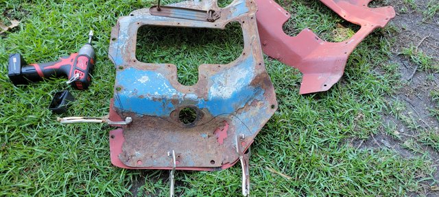

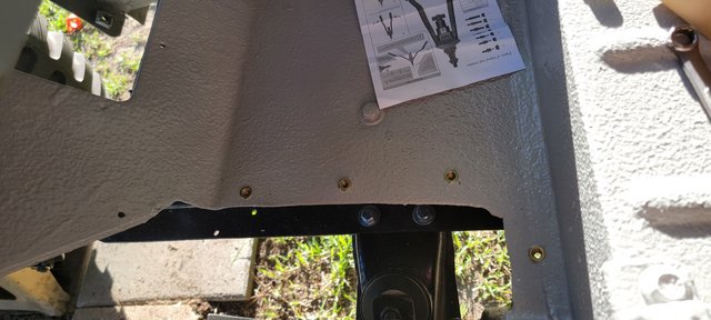

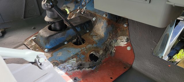

over a year ago I purchased an aftermarket transmission floor cover and I never liked how it was going to fit and the amount of mods I would have to do to make it fit.
Decided to mod the old one that did fit, to add new panel pieces.

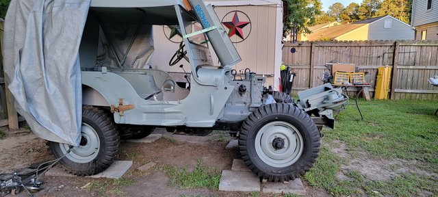

a true back yard build... doing this all in the dirt and grass.
I need a riv nut tool- I broke mine and dont feel like going to HF again for a same thing- ordered one on Amazonia and it wont be here till monday.
Int he mean time, the panel is fit and the holes are drilled.

I have to go to Norfolk to get the right pull tool for my hydraulic system. I didn't want to go down today because it was so nice. It is a rainy day visit. so I haven't done the springs "yet". soon!

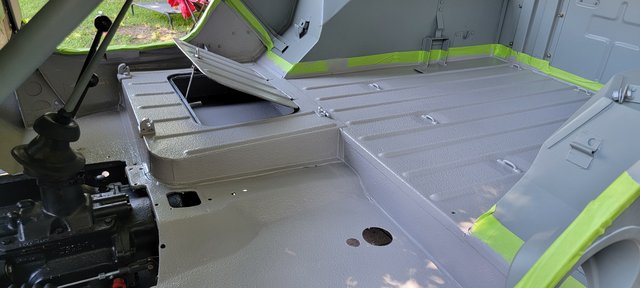

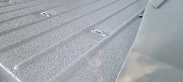

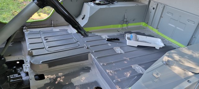

I also spent the morning recoating the tub floor, and also putting a coat of monstaliner on the transmission cover.
I bought the light quartz grey color in a gallon kit and decided to give it a go. The real color of my jeep is a tad darker than this light quartz grey.
But I am liking this lighter color more than the "medium quartz grey"
I really like how this is turning out!

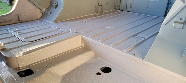

Rivetnut tool came in. all done.
I put the panels back in, just for the photo. I had let this dry for over 24 hours, but full cure is around 3-7 days.
So I took them back out after that.
Overall very pleased with it.
Few things I will be the worst critic on, but that's fine. I built it.
Putting 70 year old metal back together and I'm no pro-
I really like the light quartz grey more than the medium i had on there. Under the body, and lower piece of the rear wheel wells still are medium grey- which I think I will leave. I have 1 quart of unused product still- My feelings on this may change.
I noticed the contrast of the frame vs the canvas is very similar to the floor vs body color of the tub. I will put the seats back in later this week.
