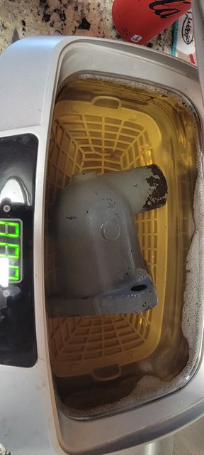

Put the thermostat housing in the ultrasonic cleaner to get the gunk out.
