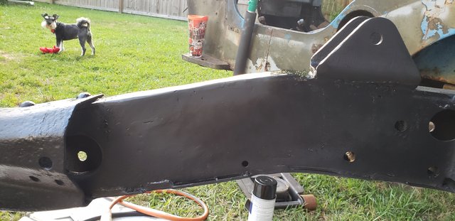

Got the frame stripped best I could.
Still need to drill out some rusted hardware and retap the holes (or nutsert them)

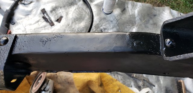

So I flipped the frame to get at the bottom side. Wire wheel all I can reach. Wire brush all I could reach. Cleaned. Out rust encapsulater on the frame and will drag the welder out tomorrow to do some more repair.
Can flip it over and install the shock mounts after I’m done on the bottom.

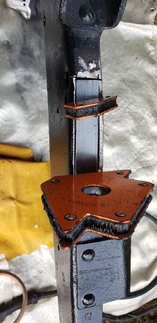

Cut these out off the driver side.
Spent half the day working on it and did this.. I used my Hobart handler 140. I was out of gas so I used flux core .030 wore instead.

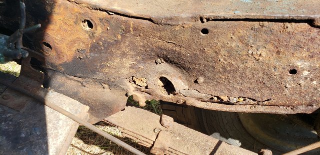

Have a hole on the opposite side I should crop and renew- this is where the old snow plow was mounted. It’s thin in the area and I cropped out all the bad and put in 10 gauge.

The snow plow really did a number on those mount holes.

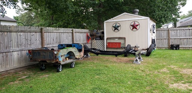

Spent time on the frame the other day and flipped it right side up.

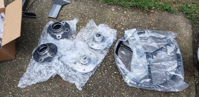

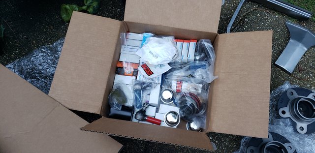

I ordered some front and rear axle parts.... doing a full recfresh on the. The front are so loose.
I did buy new hubs. The old ones are absolutely rusted I snapped a wheel stud off and expect them to be that way all the way around,

Jeep in a box piece by piece coming,

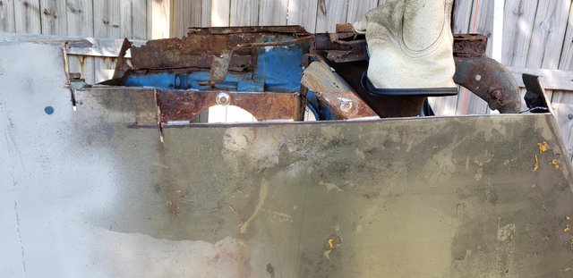

Duty onboard the ship Friday into morning of Saturday, as I left the ship, the weather dropped several inches of rain and a few thunderstorms prevented me from getting more work done than I had wanted.
I did finish tacking in the repair on the driver side.
Blew thru on a rust hole on the left and I need to finish the right side patch.

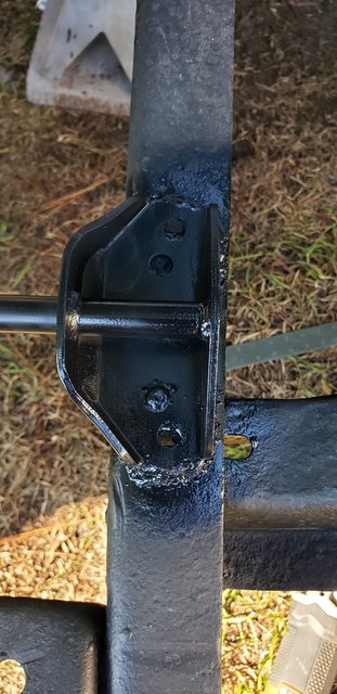

Last night I got my shock mounts welded on.
I had to weld in new front bushings too, but forgot the photo.
I did also instal my leaf spring system. Rear right and front left have left hand threads..... annoying. I won’t torque thes until I load the weight on the suspension later.
I had to drill the pivot bolt hole out to accept the 9/16” grease-able bolt. I had to buy a new drill and dewalt bit worked like butter. I tried a tractor supply drill bit that could fit my smaller check in an older drill, and it was garbage. So bought the bigger chucked d4ill and bit at Lowe’s.

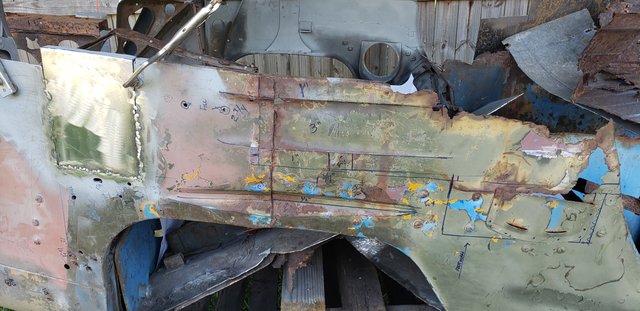

Driver side was rusty!
Got that side panel replaced and looks okay. Have a little bow in it that I will need to work out.

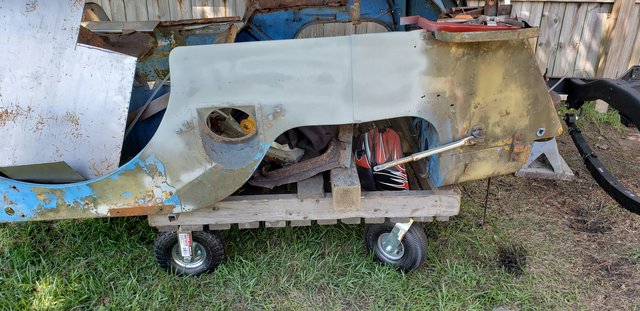

I did some hacking on the passenger side.
There is a slight recess for the axe. Though it’s hard to see with primer over it.

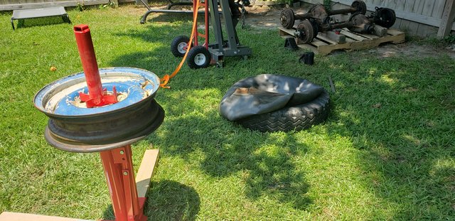

I have my axles on a pallet currently. I want to rebuild them some point beforehand I deploy again this month. I have all new bearings, seals and shim packs if needed. The opinion feels sloppy but no grinding.

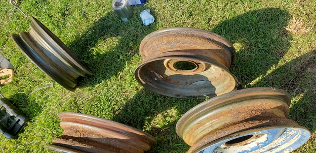

Talk about manual labor! I sweat thru my jeans and shirt doing this yesterday.
The inner tubes were rusted to the rims. The tires are 1970’s. There was a stamp on one of the tubes saying 1978. I was born in 80 and I’m 40 years old. Insane.
The tires were just shredding as I was removing them.
I took a wire wheel with my grinder, and cleared the rust chunks. No holes.

That is some very impressive work on those wheels!
