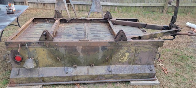

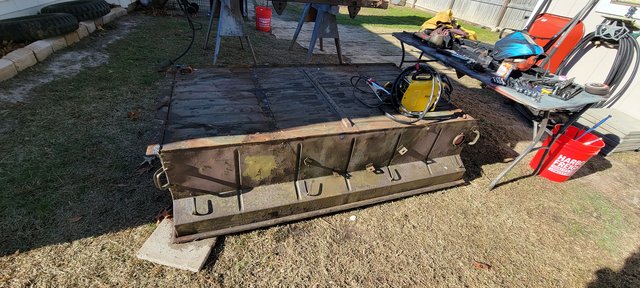

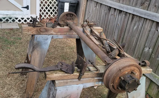

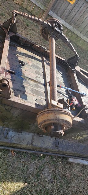

Removed the axle, leaf springs, brake cable, brake handle (need replace,evt handle), and ID'ing the spot welds holding the frame and body together. I bought a cheap plasma cutter because some of the spot welds are too tight for me to get a cut off wheel (regular electric grinder or my pneumatic one) into the spot safely. I will give that a trigger pull today.

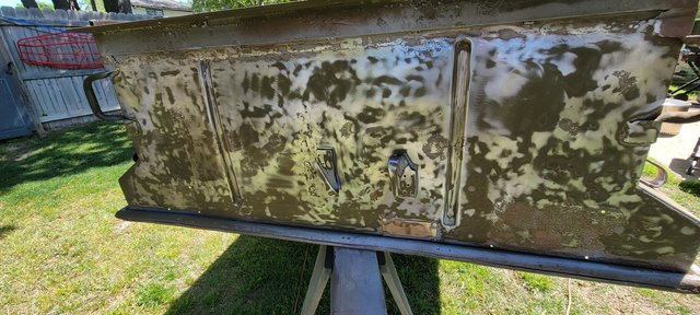

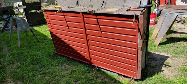

Weird yellow paint under this bracket.
The overall color appears to have been a very light OF and then a darker OD on top. There is a strange undercoat on the bottom.

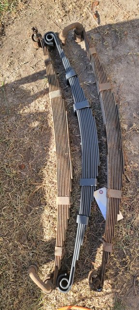

Bought replacement 10 leaf springs. The originals are flat.

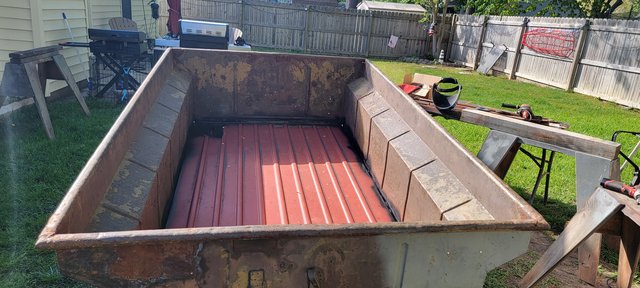

The cheap Amazon plasma cutter made short work of cutting the welds holding the frame to the body.
I've got half the floor cut out of the body now, will finish that tomorrow.
Stripped the trailer down all the way.

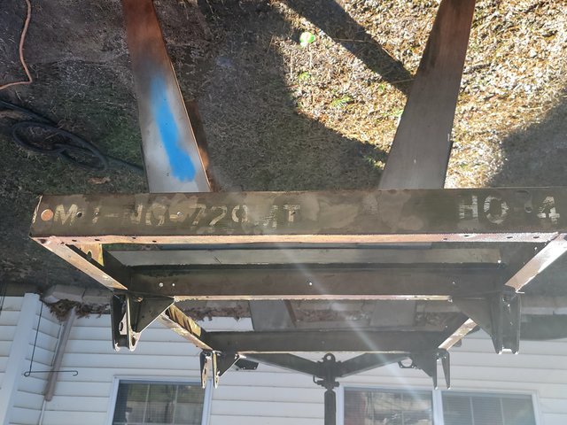

Found the unit markings while I was cleaning it,
Maryland national guard. 729th maintenance battalion. Headquarters 4.
I don't feel bad about painting over ot. I did what any good coastie would do... hide the evidence ot every belonged to someone else.

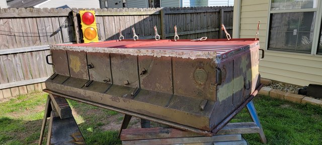

Need to flip it and paint the top part. It's going to rain tomorrow so maybe the 1st I will. And install the leaf springs and axle again

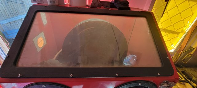

The rims are slightly too big to fit in my sandblast cabinet. So plan B is either pay someone to do it, or plan C just sand down as best I can and paint them. The bead is not in the worst shape and will hold, but they are pretty chewed up.
The frame sits on the saw horses till I mount the tires and rims. I was going to work on the body but it started snowing so I retreated inside.
Took the glass off, put the rims inside and glass back on- sandblast begin.
One rim was super easy to blast, one was time consuming with thick paint that just wouldn't budge.
Got it best I could.

Body tub is floor less.
That's where it sits till I get more time.

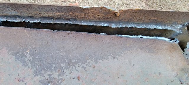

How about no...... there are a million spot welds from where the old floor is attached to the body.
Cut it off.
Welded on a new piece to this one side. Will do other side tomorrow.

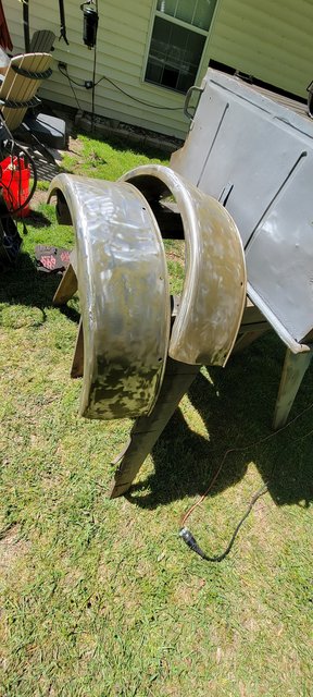

Stripped old paint off and banged some dents out. Not perfect- and not intending to.

Sanded down the sides.

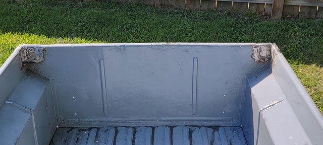

Cut the two rear top rusted bad corners off
Have metal on standby for tomorrow. Tomorrow first day off with nothing by on my calendar to be at.
Probably the strongest part of the trailer.
Ready for more epoxy and to be mated to the frame again.
