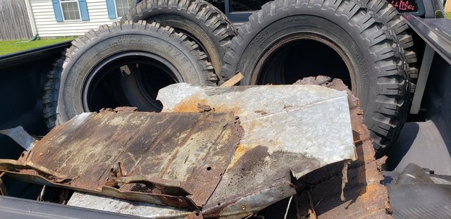

The dump takes tires for free. Sure keeps the side roads and fields free of garbage.
My back yard is lighter by probably 200 pounds of rusted metal from the Jeep.

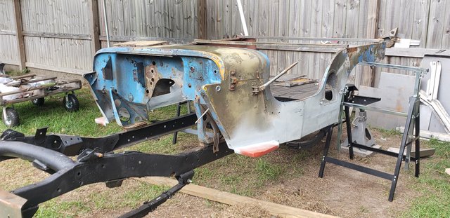

Jeep back on the frame. Again, I’m by myself on this journey. It wasn’t so bad; I just positioned myself between the dash and my Middle support bar and lifted. Used a 2x4 to help slide it up onto the frame.
If I go to take this off the frame again, I will need to use the engine hoist.

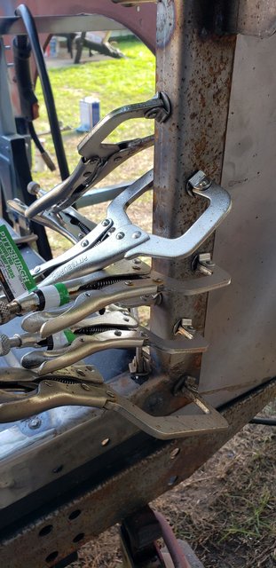

Lined up the front mounts and put some saw horses under the wheel arches. Set up my panels and clamped the bunch in.
I have probably 20 pliers clamps from harbor freight.

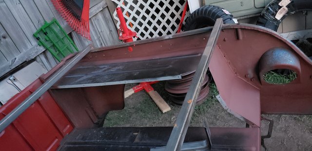

The rear floor section I ordered from Kaiserwillys and it came damaged. The fedex guy took off before I was able to unbox it and refuse shipment. It was slightly bent at the forward panel, so I ended up having to keep it.
I did get the hammer and dolly out, a 2x4 chunk and a 5lb hammer.
You can’t tell, but it was on the driver side. It was tweeted to the rear.

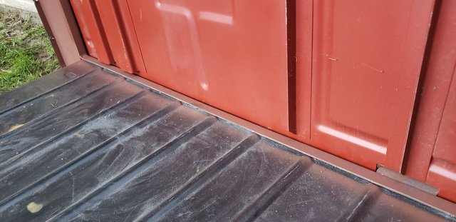

Another purchase from KW. A tailgate.
It fit good. The driver side tab on the surround panel rubs against the tailgate. A BFH and a grinder will take care of that.

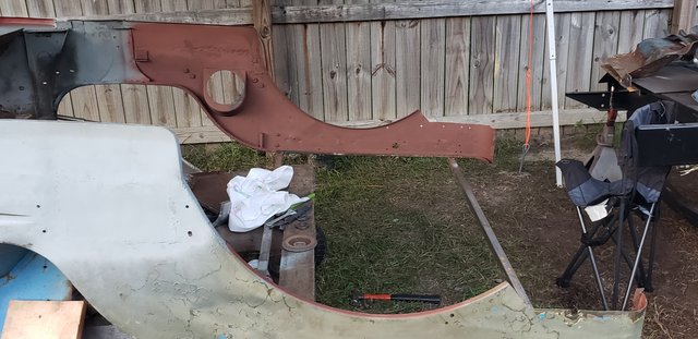

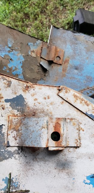

On the old wheel well panels the seat supports are spot welded in. Worth saving or are there some aftermarchet I can get? I need a new driver seat so I have to wait till that is a purchase I am going to make.

You're doing a $&% of a job on your M38. Last Summer one of my passenger seat support bracket tabs came loose. I need to weld that back on but haven't done any welding in a long time. Let me know how yours goes and what you find works best with the metal and all.

No, sorry you can’t buy those seat brackets.
But easily made. Just bend up some 16 gauge and tack them on!
The driver side has a u shape bracket tacked behind it with a hole for the seat bolt. The insert keeps the seat bracket from buckling when you tighten the seat bolt. Look at your takeoff. Again, easy to bend up. The hole has a bend in it like they took a big ball bearing and tapped it on to turn the edge down. I’m guessing to add just a little firmness to keep that guy from crushing as well.

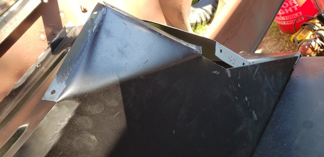

Guess what.... aftermarket panels don’t fit,
I did out in the wheel house panel on driver side.
It isn’t bowed a little and had to manipulate it to sit stil

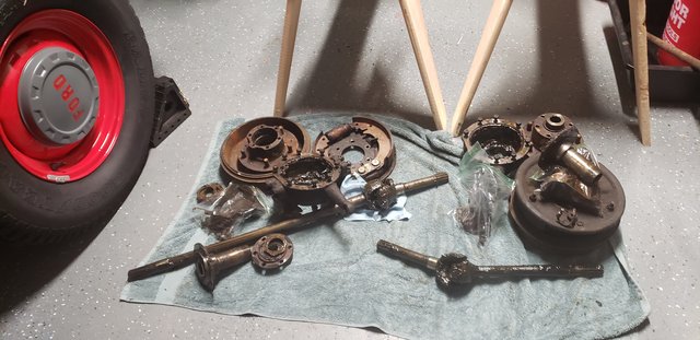

Dana 25 is pretty loosey goosey.
I started disassembly at 4pm, but had to do some chores in the house before I started the other side.
Axles and accoutrements all in the garage. I will wipe it all down and put some of these in the parts washer today after work.

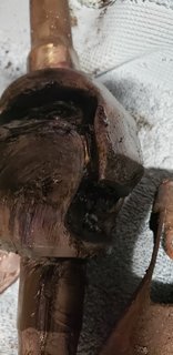

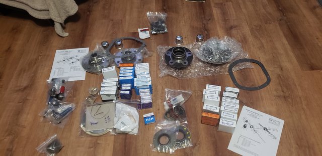

When I went thru the axle bearings and rebuild kit I bought from KW, I found I am missing one king pin bearing. I got 5 cups though. Will need to take care of that before reassembly. I purchased another pinion bearing so I can set the pinion.
The diff smells burnt. Had some separated material in it with the grease. Not water though.

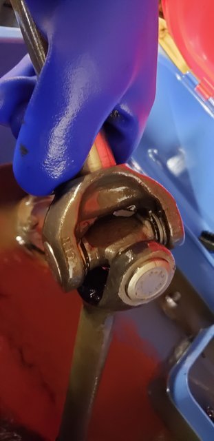

I even found a small tab with “bendix only” stamped on it.

See that I have one bendix joint on the long shaft, and a spicer on the short one (Dana 25)
Looking around in some of my books and online, I assume this is fine....
