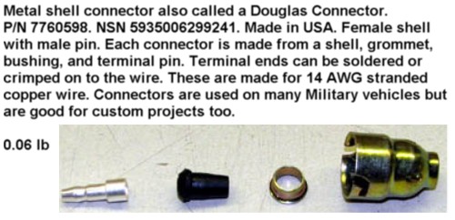

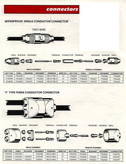

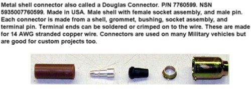

Plenty of Douglas connectors, kits and tools on the market still.
[image]https://www.willysmjeeps.com/app.php/ga ... 711/source[/image]
[image]https://www.willysmjeeps.com/app.php/ga ... 712/source[/image]
[image]https://www.willysmjeeps.com/app.php/ga ... 713/source[/image]
[image]https://www.willysmjeeps.com/app.php/ga ... 714/medium[/image]

Wes,
Thanks. I found a Douglas crimping tool on eBay, which I’m sure I will need for more parts of the larger M38A1 project.
Jeff
