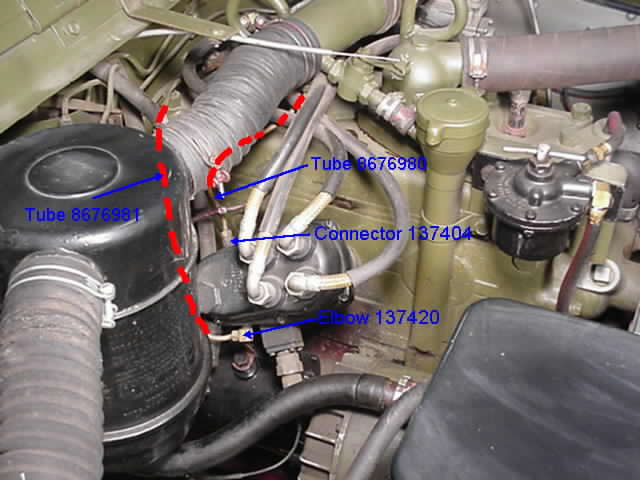

I can see your pictures no problem! It looks like you have an M38 style distributor but someone has plugged the ventilation ports and then painted the cover that copper color. If you go to page 11 of the "M38 Underwater Ventilating System" document here on the site, you can get a good view of the two lines that tie into the sides of the distributor body:
M38 Underwater Ventilation System
As for your spark plugs, if you want to run traditional style 12 volt spark plugs with the 24 volt style waterproof wires and distributor, there are adapters available from various sources online for that:
https://jeep1942.com/?page_id=9592
This site has some great images showing what it looks like assembled.
Hope this helps!

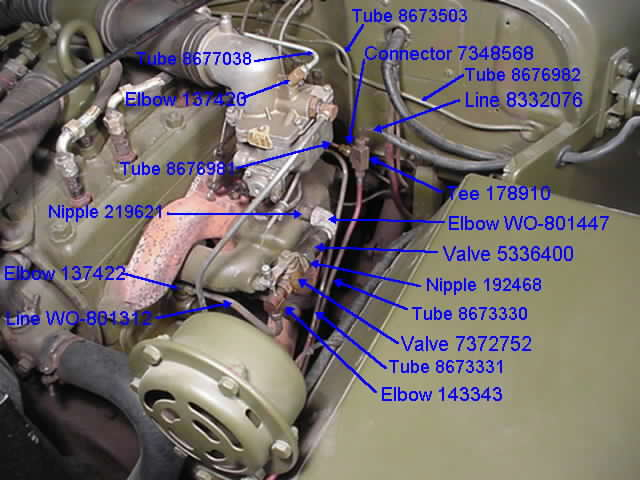

These should help.
[image]https://www.willysmjeeps.com/app.php/ga ... 190/medium[/image]
[image]https://www.willysmjeeps.com/app.php/ga ... 187/medium[/image]
