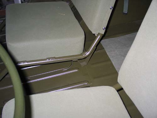

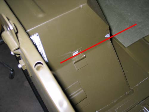

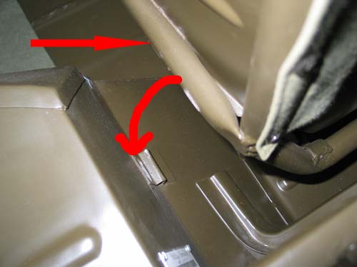

Ryan,
Here are a couple of more photos from my jeep to help you.
Greg
