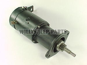

looks like a 4113 mb cj2a starter, probably have a mismatched bendix and flywheel combo
Posts: 16461
It may just have a different drive installed or the armature may be different. No data plates on the starter? I think it's a CJ3A MZ4137 or MZ4163 starter. Both of these have a 9 tooth pinion for use with the M38's 124 tooth flywheel ring gear. The MZ4113 had a 10 tooth pinion for use with the WWII & CJ2A 97 tooth flywheel ring gears.
This is the MZ4113 drive:
This is a CJ3A MZ4137:
and a MZ4163:

Posts: 16461
Jeeps gave you three different flywheels from 1941 thru 1971 on the L & F-134's.
97 Tooth MA, MB, GP, GPW, GPA, & CJ2A uses 10 tooth pinion MZ4113 starter
124 Tooth CJ3A and Early M38. Uses 9 tooth pinion starter
129 Tooth. Late M38, M38A1, M170, CJ3B, CJ5 uses 9 tooth pinion starter.
http://willysmjeeps.com/v2/modules/gall ... .sized.jpg
My money says you are running a 10 tooth Pinion MZ4113 starter with a 124 or 129 tooth flywheel. Your pinion looks like it has been chewing up the incorrect flywheel.
Gets some photos up on your photo page to help ID which engine you have and then decide which flywheel 124 or 129 tooth you wish to use. You will need to match your engine's bell housing to the correct flywheel for it. If your MZ4113 starter fit the bell you have ok then you either have the very early MB/GPW/CJ2A bell or the early CJ3A & M38 bell which means you need a chip free 124 tooth flywheel and a 12 volt ciccy starter with a 9 tooth pinion that mounts with two 1/2" diameter bolts.
