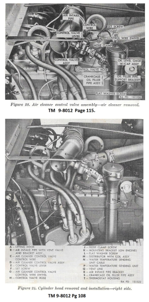

[image]https://www.willysmjeeps.com/app.php/ga ... 492/medium[/image]
Note line "Q" in the lower illustration. That is fresh air being sucked into the distributor body by intake manifold vacuum which is boosted to an even higher flow rate with the added punch of the CORRECT dual vacuum/fuel pump. Using manifold vacuum alone as your suction source may or may not be adequate depending on the amount of suction available to cool the coil. This discussion seems to be related to the one I was just in on facebook. If so a proper ID would help avoid any confusion. If this is the same discussion then my previous suggestion in that discussion takes precedence.
