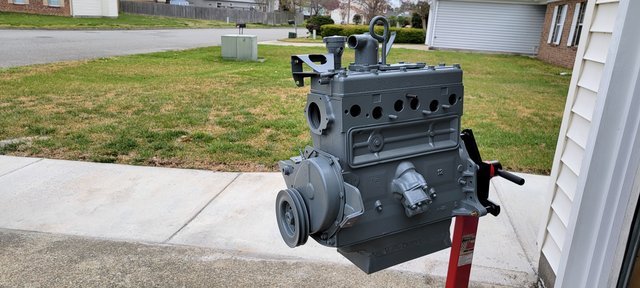

Picked up myengine today.
Posts: 2077
Looks very nice! (and for that price on the receipt it should!)
I have to ask about the unusual square shape of the oil pan with no skid plate? Where's the drain plug, on the bottom?
It looks like it must hold a lot more than 4 quarts!
And the single hook on the engine lift plate?
I'm guessing they were there when you bought it.

2 questions:
1 - Why the odd looking lift ring bracket with only one lift ring?

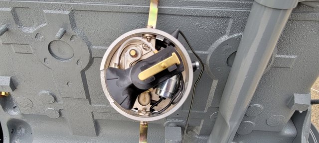

2 - Why the civilian distributor?

Remove all that grey paint around the intake and exhaust ports. To find out how much must come off temp fit the intake/exhaust and trace it's casting onto the block.

The lift plate had two hooks at one point in its life. The nub of the other is on it.
Civi distributor- PO put 12v. I am leaving 12v too. I can do 24v, but for price and the fact nothing is factory on my Jeep- I don’t feel the need to 24v.
The paint around intake/exhaust- I am going to. Have to dig out the manifolds from my parts stash.

Oil pan- yes it has a drain plug on bottom. The pan has been welded- skid plate thick. If it wasn’t a army pan, the PO did it.

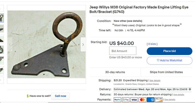

I got an email from Ebay this morning- it had a few "we think you would like these" sort of things.
This was one of them.
https://www.ebay.com/itm/325133692729?m ... nl%3Dmkcid
This is exactly like the one on my engine.
Hey, so my M38 came with the same kind of lift plate. It clearly was broken off. I spoke with a buddy or mine, some years ago, that restored his M38 with the help of his dad who had worked on them while in service - apparently it was common for those to break off due to any number of causes.
I did buy a repro lift plate with both hooks but the holes are drilled slightly further apart than the original and than fit with the bolts. So it's sitting on my parts shelf.....

For $8.50 more you can buy a NOS lift plate that has both rings here:
https://www.ebay.com/itm/183164759268?e ... SwsO1axtCr

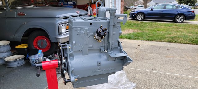

Did the previous owner leave you with an extra-long dip stick (or custom marks) so you can make sure to keep enough oil in the pan for the oil pick-up float to work properly?
I'd be curious to know how many quarts it holds to the full mark.
I hope your engine builder pulled the cover off the oil pick-up to clean it.
I found mine like this (after the previous owner did a "rebuild"):

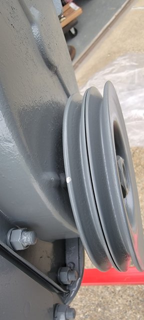

It looks like the timing mark on the crank pulley is just painted on...you might want to hit that spot with a V shaped file so it doesn't disappear by accident.
Mike B :)
Mike_B wrote:It looks like the timing mark on the crank pulley is just painted on...you might want to hit that spot with a V shaped file so it doesn't disappear by accident.
Mike B :)
good call. Will do that today.
Will drop the pan. Check the float and also distance for the oil.
I could just buy a pan- and dip stick.
I actually don't know if it has custom marks on it- but I will check.
