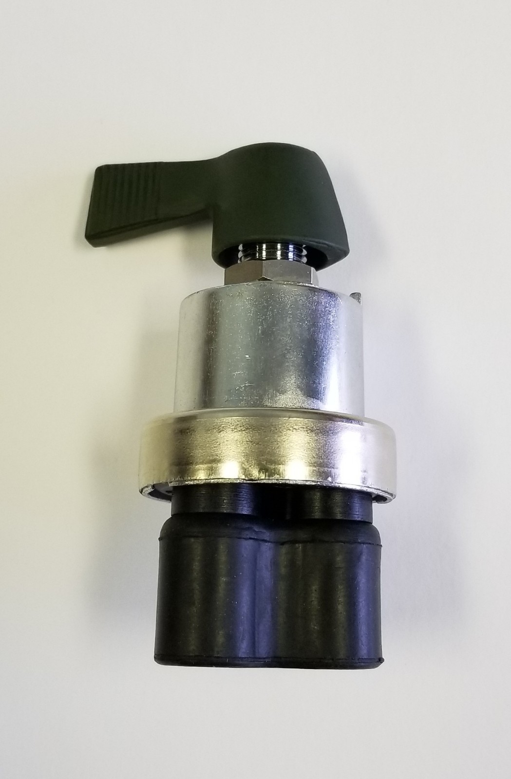

Since I am hardly a CJV35/U Guru I forwarded the question to Bob Westerman who was a great help.IS that switch in the dash to the left of the steering column the light switch? It looks similar to M series ignition switch. I am looking for one of those, how many positions does it have?
he also sent these photos:The CJV35 light switch is unique to the V35 but looks similar to late MB light switches.
Since the V35 doesn't have any type of blackout lighting the headlight switch is wired up just like a CJ-3A light switch although it looks very different.
I did a little bit of research on the WWII main light switches:
ORD# 506605 Switch, Light, blackout, push-pull, safety lock, assy (Main Lights) Probably the early 1st type switch.
Then came two later switches, both rotary types produced by Douglas Manufacturing (DM):
DM# 6203, WO# A11867, Ford# G8T11654 Switch, main lights, rotarytype
DM# 6244, WO#A11866, Ford# G8T11649, ORD# 7036582, NSN 2590-00-703-6582 Switch, Mian Lights, w/circuit breaker, assy. (rotary type)

The CJV switch pictured above also has a circuit breaker. I forgot to querry Bob on the part number in the CJV35/U parts manual.
Note, the WWII jeep used a separate 2 pos push-pull sw for the dash lights and a separate two pos push-pull sw for the BO Driving lamp on the fender.
