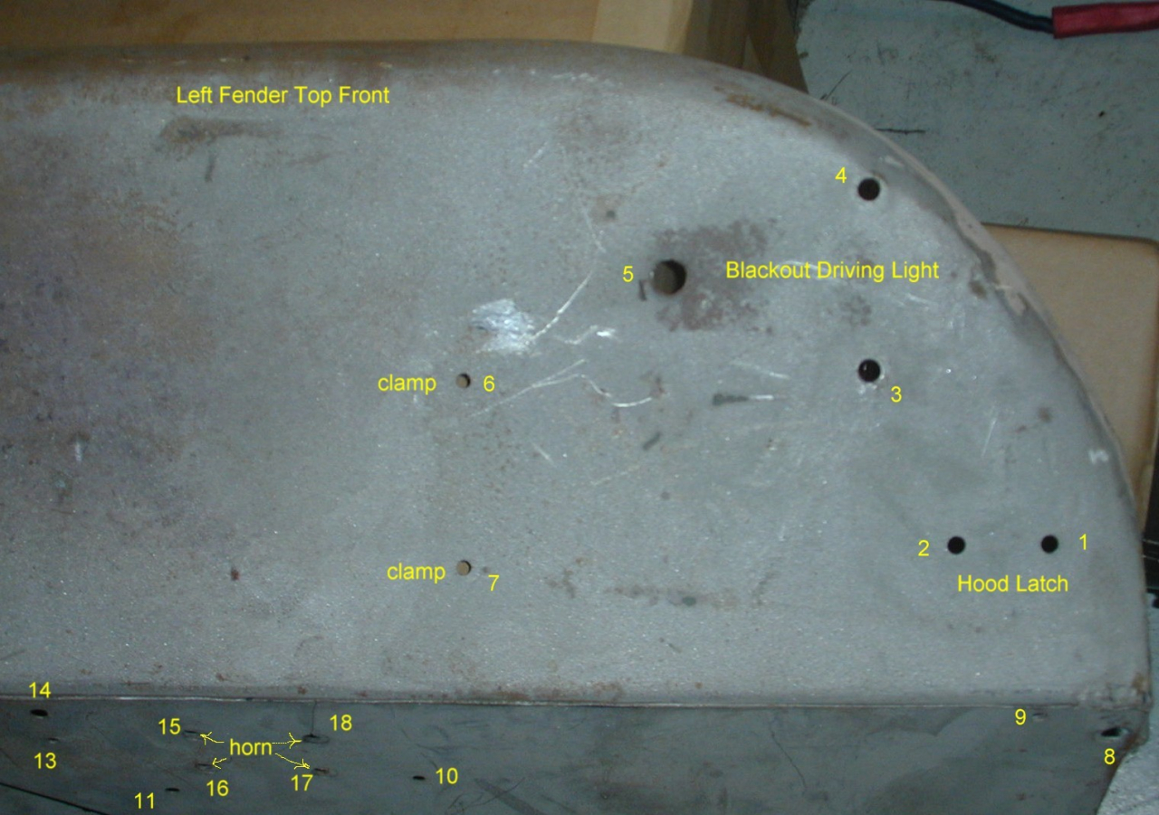

I am rebuilding a 1952 M38 CDN and looking for the location of the drivers side fender Blackout light and horn.
I'm looking to see if anyone has an available diagram as my fender has most holes plugged and I'm struggling to locate the exact location.
Any info would be greatly appreciated thank You

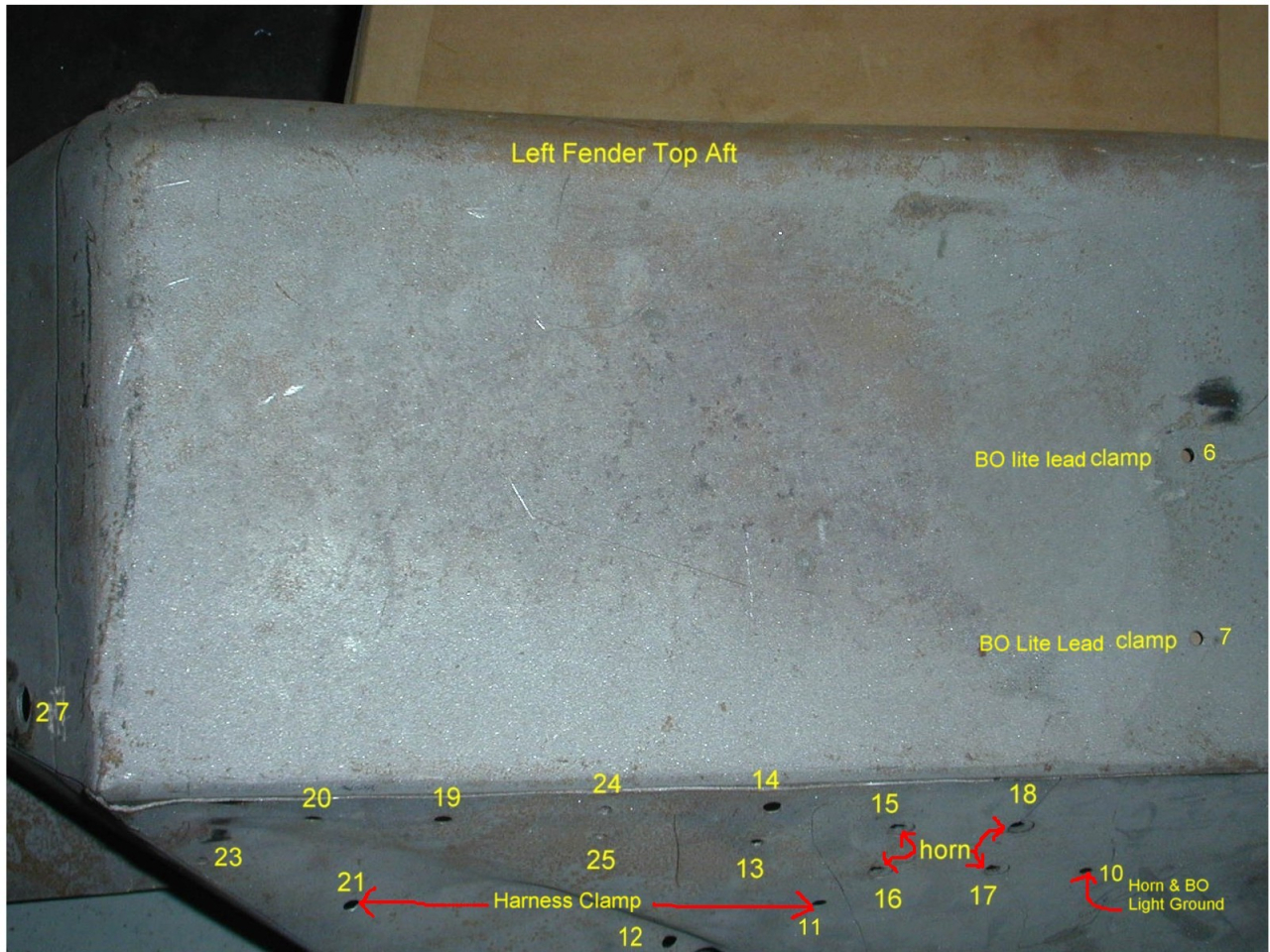

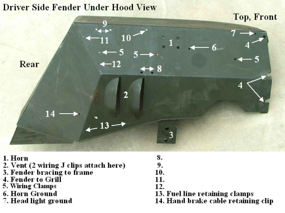

I don't have dimensions handy but these should still help. I can take some measurements tomorrow on my project.
