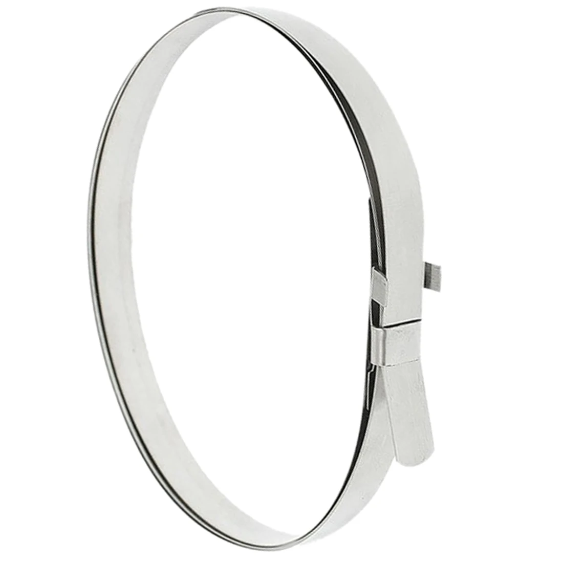

My experience with the CV joint style clamps are they are a one time use clamp in most cases. It would help if when you wish to discuss the use of a part other then the original designed part if you then included a photo of at least the the substitute clamp so we can all get on the same comparison page.
I'll try to help out with a couple of examples of what I think you are referring to:
140mm to 160mm narrow screw type CV joint clamp
Ear type CV joint clamp
Band type CV joint clamp
