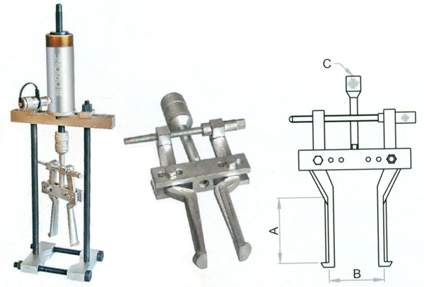

What's the best way to remove the wheel bearing cups from the front end flange/hub?
The cups are facing out and are the same diameter? so how do you get behind one to drive it out?
Does the "remover replacer" shown in the manual expand to fit one cup after passing through the opposite cup? If so, where can I get one?

If the races / cups are the issue:
https://www.google.com/url?sa=t&rct=j&q ... bs.1,d.b2w
http://www.triseal.com/old/techbullet/TMC_RP_622.pdf
Some folks prefer to tap in a progressive circle and some prefer to tap back & forth or side to side.
You need a tapered punch:
And it helps to keep a set of brass punches handy:

There are many just open up your wallet!I was wondering if there was a better tool than a punch. Something that would expand once past one cup and engage the shoulder of the next cup.
From this simple to:
Just let your fingers do the walkin in the yellow pages!

Just keep in mind that every time you drive one out cold you take metal out of the hub with the race. It pays to warm the hub before removal and installation and it pays to freeze the race before installation.
